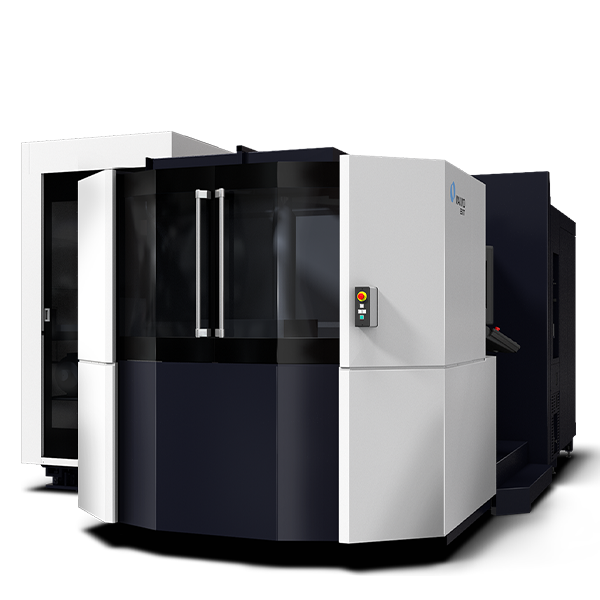

Makino takes five-axis horizontal machining to the next level with our a500Z. We offer:
  • High rigidity resulting from the a500Z’s unique double slant structure and true three-point leveling. Makino has developed multi-axis CNC milling machines that are highly productive, maximizing metal removal and minimizing perishable tooling costs.
  • High accuracy through integrated active temperature control, including ball screw core cooling, direct drive rotary axes cooling and spindle jacket cooling.
  • Automation ready with features promoting easy integration into direct robot load systems or Makino’s MMC2 pallet handling system. When integrated into an automated system, you can expect spindle utilization rates of up to 95%, and fully-unattended operation over nights and weekends.
