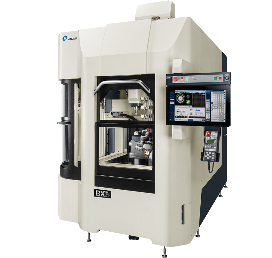

EDM hole drilling uses an energized rotating tube electrode with high pressure flushing to produce fast and accurate machining of small deep holes in conductive metals.  Makino’s EDM drilling machines are designed for the highest level of accuracy, reliability and productivity and offer unique solutions for high volume production applications.

Touchscreen control
Makino EDMs stand apart with the intuitive Hyper-i control system, a streamlined and efficient interface that helps you get work done faster.  A large high definition 24” touch screen functions like a smart device (phone/tablet), allowing operators of all skill levels to benefit from its inviting and familiar operation that substantially reduces training requirements.  The Hyper-i control further elevates an operator’s capability with several integrated advanced functions, such as hyper-linked digital manuals and video tutorials, E-Tech Doctor, and EZ-Cut that deliver higher levels of productivity to the operator’s fingertips.
All models use a stationary work table design and a 3-sided rise and fall drop tank for easy automation and enhanced productivity.
EDFH-Series
With pinpoint sub-micron precision and outstanding surface finish, these are ideal for small electronics and micromachining applications. Built on the EDAC-1 machine platform, the machine can perform ultra-high precision sinker EDM operations as well as small hole drilling.
EDAF-Series
With a focus on high-precision small hole drilling and excellent edge quality, these also have the flexibility to execute standard sinker EDM operations.
EDBV-Series
Designed for high-volume production these precise hole drilling machines achieve the fastest speeds with multi-axis contour machining to produce shaped hole features common to turbine engine components.
