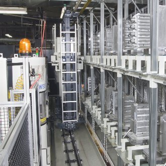

The next step was to implement a flexible manufacturing cell by purchasing an MMC2 automated pallet handling system with 24 pallets to automate its existing a51 horizontal machining centers.
The larger tool magazines provide unattended, uninterrupted machining, eliminating the need for manual tool changes. Operators are able to keep tools for common jobs at hand to accommodate quick production runs that may be added.
MacKay next invested in another flexible machining cell with three Makino a51 horizontal machining centers. Because 85 percent of MacKay’s business is repeat orders, producing custom fixtures on a standard machining platform is another good example of how MacKay practices lean manufacturing.
MacKay’s two flexible manufacturing cells run 24/7. With 24 pallets, the spindle is always cutting, freeing up operator time to work on other tasks. The company no longer keeps track of setups because they are now nonexistent.
