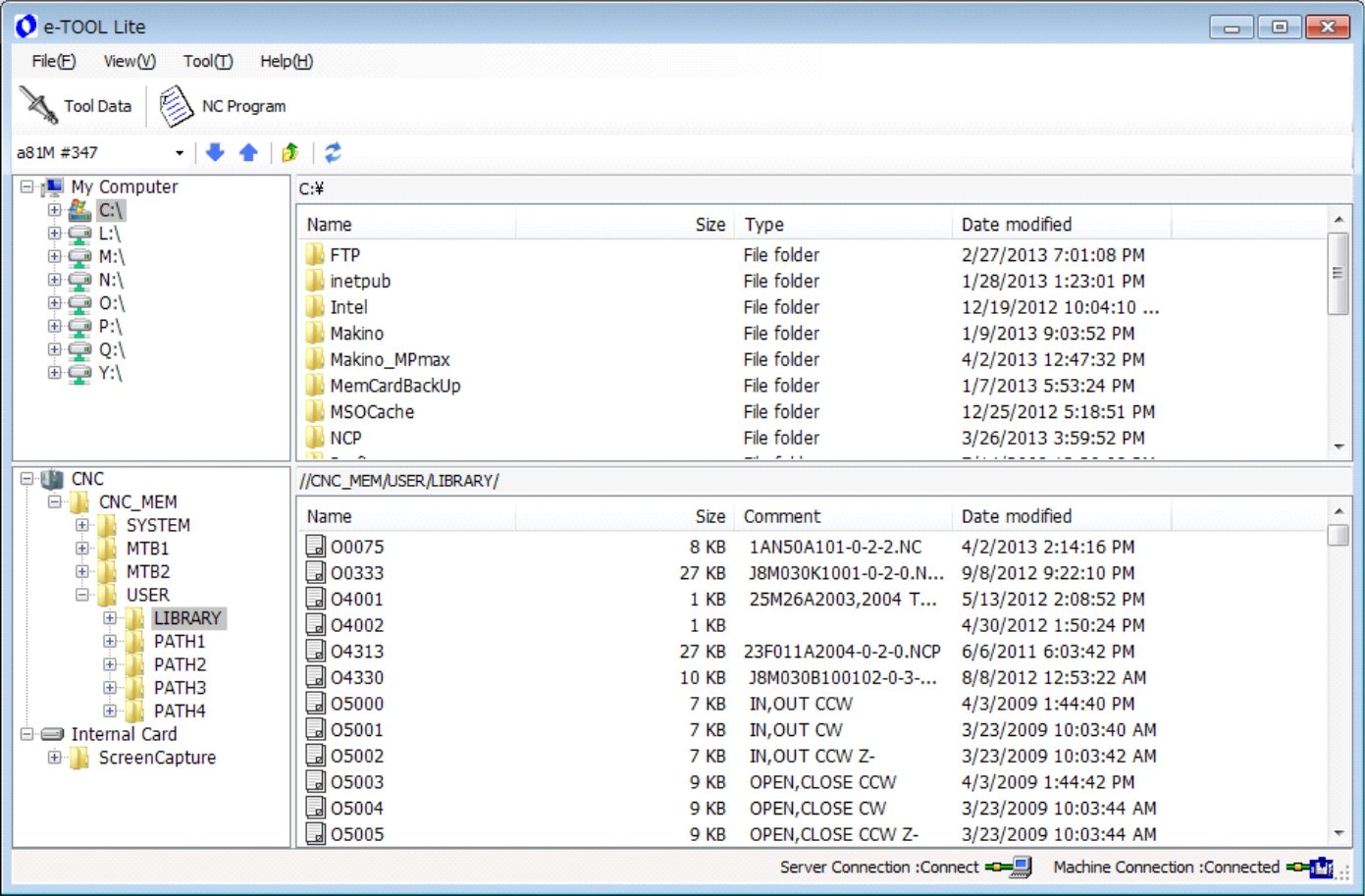

    Tool Data Management
    Monitors tool length, diameter,offset and alarm data.This actionable data can help maximize tooling life cycle. It also helps the system know what tools are available at each machine. Manufacturers can use the data to find replacement tools before the process stops due to tool shortage.

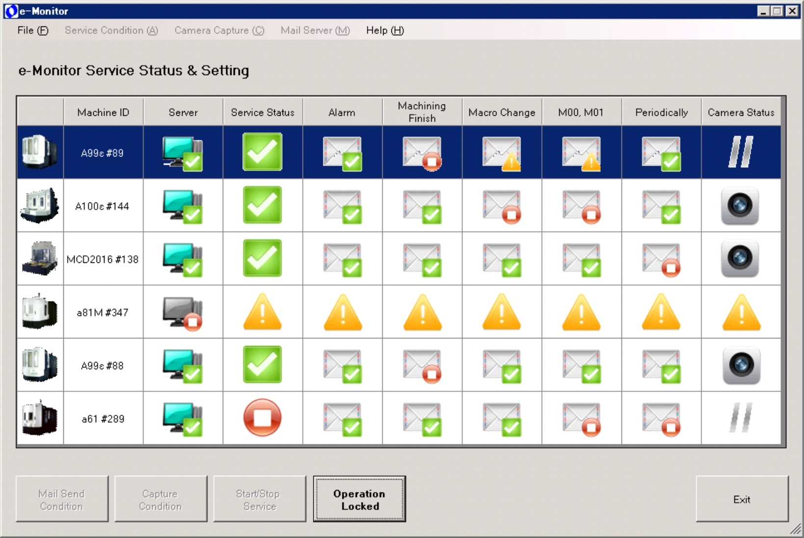

    Email Notifications
    When a machine alarm activates, e-mail and/or text messages can notify personnel. This feature enables operators to deliver detailed machine status information to their service department, including alarm descriptions and images of the work zone. This information can help them address problems as they occur, and can dramatically improve productivity and process control. Personnel can choose to get notifications in the office, on the road or at home and across a variety of devices. As with all remote communications, a company's IT department typically determines how and where this accessibility occurs.

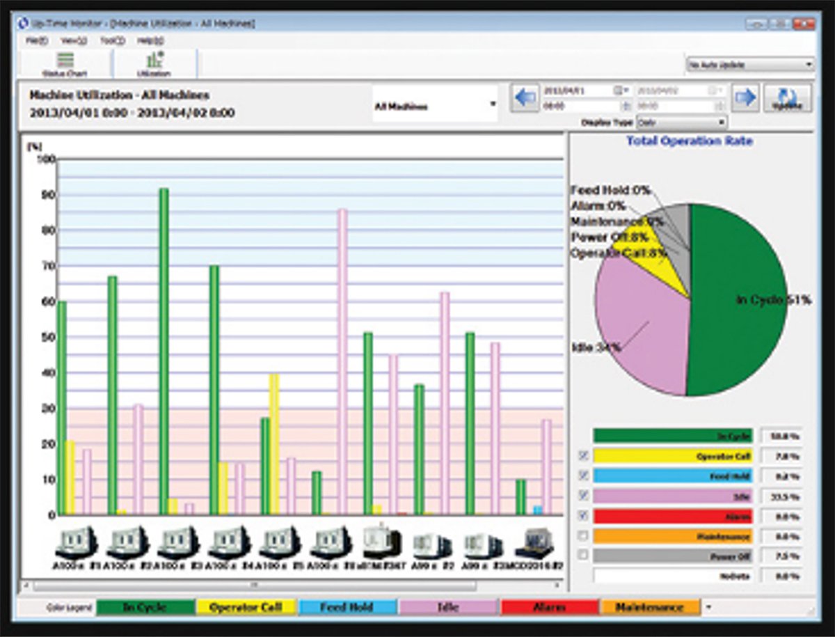

    Machine Utilization
    Displays how much time the machine has been in cycle or out of cycle during a specified time period. Also displays spindle cut time (the time the machine spindle makes chips), allowing full efficiency analysis. Keeping track of machine utilization is a key element of real-time production monitoring.

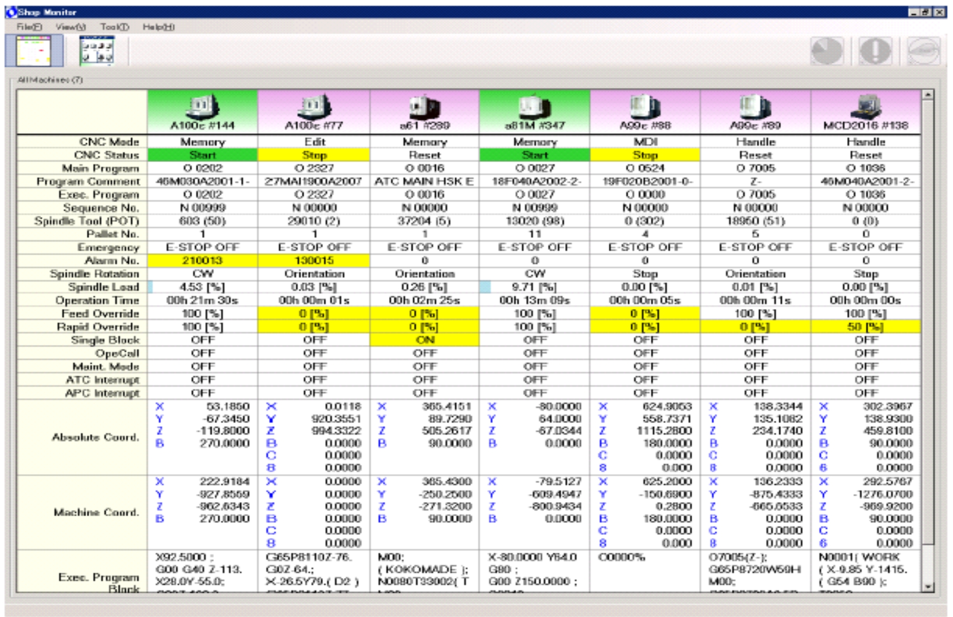

    Multiple Machine Status
    Displays the state of each machine, specifically whether or not it is running, by displaying “in cycle,” “out of cycle” and any alarms - all shown in real time. These alerts are recorded for later analysis. The alarm analysis feature lets personnel retrieve additional information about alarms, including how often they occur.

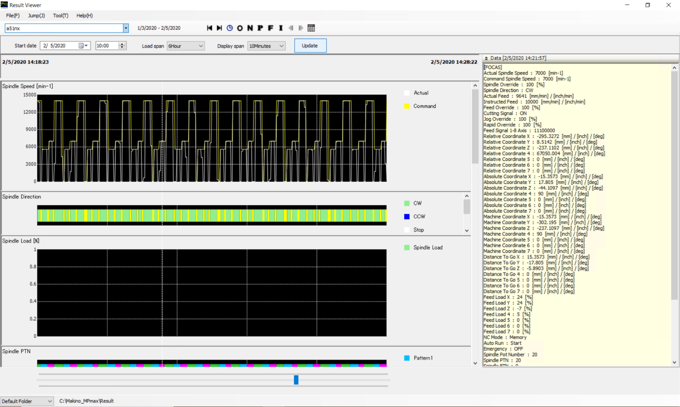

    Result Viewer
    Tracks spindle load, axis loads, feed/speed, active program, spindle tool, alarms and other factors related to machine operation. The data is recorded and archived, and users can sort by spindle tool number, alarm number and active program. That way, if there's a performance problem or alarm, the data can lead to accurate resolutions. Additionally, if there is a spindle incident, personnel can see exactly where it happened in the program. Some types of software record the incident to the exact line number in the NC program where it happened, helping the operator easily adjust the cutting parameters.
