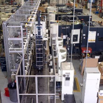

The company invested in advanced machining technology to enhance its production capabilities by purchasing these five technologies:
   •  A MMC2 modular machining complex with 161 pallet stations
   •  Two a61 horizontal machining centers with automatic tool changers
   •  Two a71 horizontal machining center for heavier machining on cast iron
   •  A S33 vertical machining center with dual pallet changer
In one work cell at Prince, there are two a61 machines, an a71 and the MMC2 system. This flexible manufacturing cell is used for high-mix and low- to medium-volume orders.
The S33 machine provides Prince with a flexible mini-cell for quick setup and changeovers. This cell is used for running short, flat parts of 10 to 15 count batches with the automatic pallet changer.
Efficiency is at 95 percent with the flexible manufacturing system in place. Prince runs 24 full pallets of work around the clock, seven days a week. A part has never been rejected, and all scrap has been eliminated. Every part comes off of the cell and goes straight to the customer.
Throughput time from raw material to finished product has been reduced by 50 percent as Prince is able to go from producing three to four parts per hour on stand-alone machines to six parts per hour. In addition, the flexible manufacturing system provides immediate response for managing workloads, enabling Prince to practice lean principles. If the company receives an order from a customer, it can acquire material the same day, provide one setup and then start production immediately. In addition, customers with lower volume jobs receive the same part cost as they had with mass production runs.
Quality has increased. Prince can manage three-dimensional parts having tight tolerances on several different positions, with diameter tolerances of 0.00052 inches. The company estimates it’s saving 20 to 30 percent in cycle time on tool changes alone. It runs a flexible manufacturing system for 22 hours a day and has yet to have one rejected part come across its machines.
The new cell means less setup and less labor. Operator intervention has been reduced from one operator per machine per shift to one operator per three to four machines per two shifts. Prince can run three jobs simultaneously while the operator prepares the next three jobs within the cell.
The flexible manufacturing system enables prototype development at Prince—helping the company take a part from cradle to market in record time. It is estimated that with all of the time saved and related benefits, the MMC2 and associated horizontal machines will have paid for themselves in one and a half years.
The tools that were added to the S33 mini-cell eliminate post-production deburring, saving on benchwork, cleanup washing and post-production time. This efficiency gain eliminates another 5 to 10 percent in cycle time.
