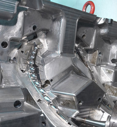

A Makino a92 horizontal machining center (HMC) was chosen to replace its existing vertical machining centers (VMCs). The company had already seen a similar Makino VMC in action in a shop where it had previously outsourced its hardened material applications. Cavalier Tool chose the a92 based on its similarity to that machine, and because of the positive experience, longevity and reliability it had with its previous Makino investment.
RESULTS
In hard metals, the a92’s best feature has been speed. It completes jobs with triple the productivity of previous processing techniques, with spindle uptimes at 90 percent.
This speed is attributed to setups having been cut in half due to features such as the automatic pallet changer and the 92-capacity automatic tool changer. Because pallet changes are completed in just 23 seconds, the company can also introduce more tools into its process. Both the pallet and tool changes occur without interrupting workflow.
The rigidity of the a92 has also enabled Cavalier Tool to significantly reduce the time spent performing benchwork. The machine is highly accurate, exceeding specifications with tolerances under plus or minus 0.0001 inch.
Due to this new investment, the company is now able to do more with less. It has increased production even after removing seven previous machines from its shop floor. The purchase of the a92 has also enabled it to bring the hard-metal machining business that had previously been outsourced back into its own shop. It is now completing jobs in hardened metals twice as quickly as it would on competitive machines.
