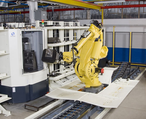

The flexible manufacturing system brings accuracy to the entire operation. Chicopee has replaced machine pallets with smaller fixture plates that are center-mounted for full tool access. These fixture plates help reduce fixture costs.
Parts move through the cell efficiently, in keeping with the just-in-time production that is employed to account for the high cost of raw materials. The flexible manufacturing system produces parts 24/7.
The 8,000-rpm spindle on the a81M provides the power and precision needed to cut titanium, and the company plans to add three more a81 machines to its operation as orders for production aircraft get under way.
