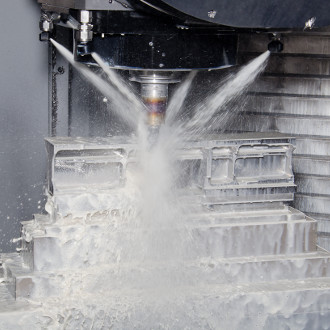

Dynamic NC purchased two T1 5-axis horizontal machining centers — the first two of these machines sold in North America. It liked the T1’s rigidity, stability and kinematic structure.
Soon after, it also purchased two MAG3.EX 5-axis horizontal machining centers to handle new orders for complex monolithic aluminum aerospace parts.
The T1’s rigidity has enabled Dynamic NC to perform hard-metal machining without limitation and with complete accuracy. The company has been able to reduce cycle times by 50 percent, extend tool life by five to six times and reduce machining labor costs by 80 percent. This has enabled Dynamic NC to provide its customers with the lowest achievable part costs in challenging part applications.
The machine’s range of motion has reduced setups and labor, and has helped the company achieve additional accuracy in its parts and longer tool life.
The MAG3.EX has only been in use at Dynamic NC for a short time, but has already helped lower cycle time, as well as labor and tooling costs—further reducing Dynamic NC’s total cost of operation.
