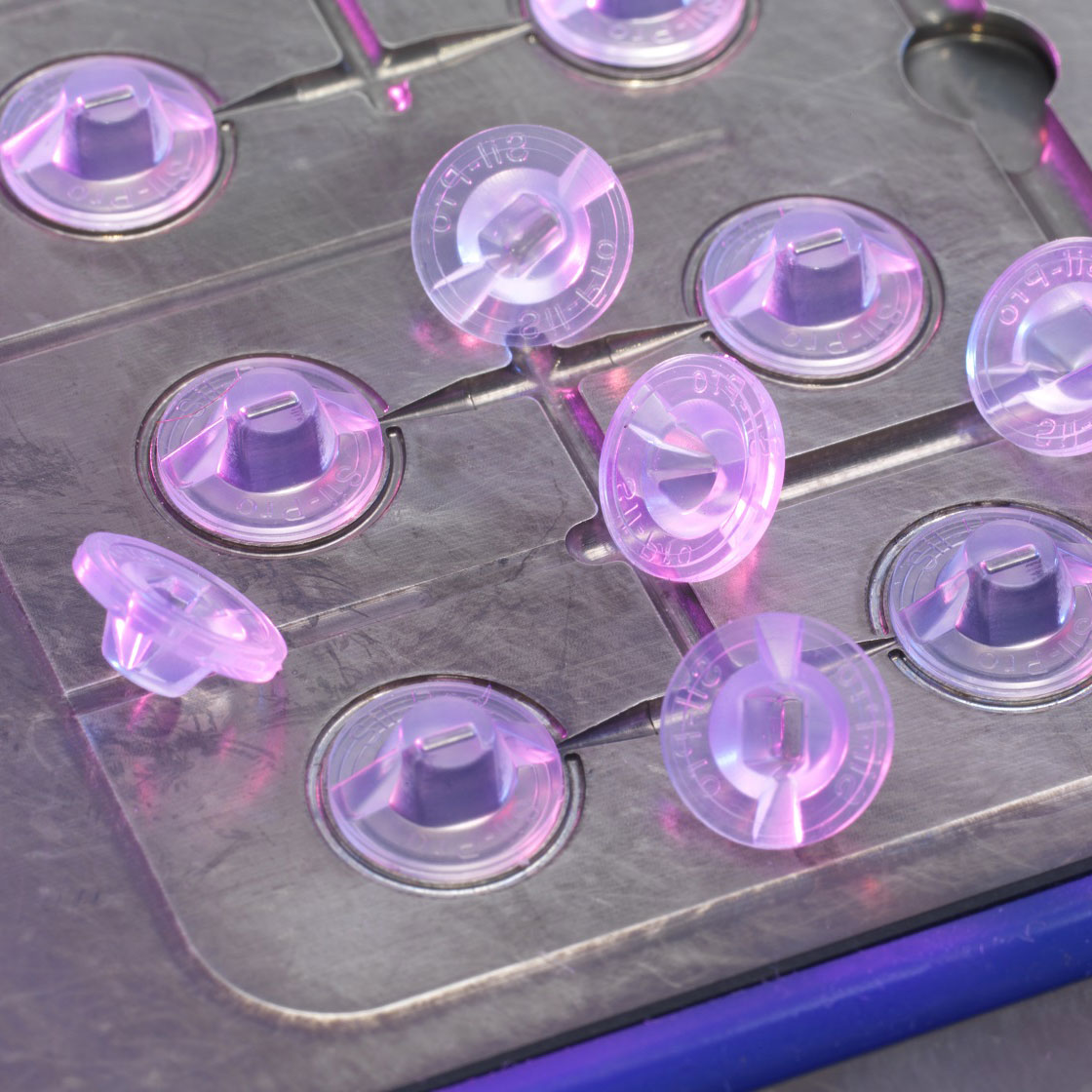

Not long after incorporating the Makino machines on the shop floor, the company was operating unattended with consistently accurate results. Flashing was eliminated, which brought cycle-time reductions of 25 to 40 percent while still achieving 4 to 8 Ra surface finishes and tight shutoffs.
The surgical molds are completed in just one operation with the Makino machines. The equipment is reliable and consistent, and the molds come out perfect, needing no hand finishing. On features that cannot be milled, the EDGE2 is employed to create parts featuring deep ribs and sharp corners.
