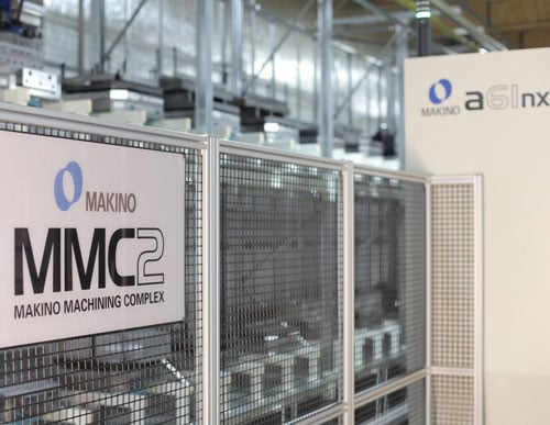

Micro-Mechanics established a platform for its 24/7 machining process by investing in a reliable and repeatable automated machining system that consisted of three Makino a61nx horizontal machining centers and an MMC2 track pallet system with MAS-A5 cell control software. The company built on this technology with standardized processes across all departments, including tooling, fixturing and programming.

Micro-Mechanics’ investments in an automated machining system and standardized processes have led to improved part accuracies, better surface finish and up to three times longer tool life. Fixtures can be transferred between like tombstones without any offset adjustments and still hold positioning tolerances within 0.0005 inches across all coordinate axes. As a result, the company no longer needs to produce test runs.
Micro-Mechanics is nearing its 24/7 machining goal of 95 percent spindle utilization, or 160 hours of weekly production, while also striving to make on-the-fly adjustments to the company’s production schedule, with 100 percent success and virtually no downtime.
