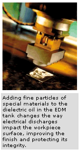

Additive Technology

"Diffused Discharge Machining" (DDM) technology is another option for EDM finishing that relies on additive technology. This process minimizes the effects of "secondary discharging" and breaks the spark up into multiple sparks through a conductive medium in order to produce superior finishes in dramatically less time. It increases pulse frequency at the lowest output levels by as many as five times. This technique also improves the frequency of discharges when machining large areas, where "chip" build-up has traditionally made consistency a problem.
An example of diffused discharge machining is Makino’s HQSF (High Quality Surface Finish), which utilizes a patented conductive powder the company has named "µSC." This powder is mixed into the dielectric fluid. When the spark gap is controlled consistently and this additive is distributed evenly between the electrode and workpiece, spark frequency improves because there is a more conductive channel allowing the smallest sparks to fire evenly.
DDM technology reduces the loss of power associated with re-machining of chips or "secondary discharging" experienced in conventional EDM technology. A 30 percent improvement in machining performance may be realized. Not only is the surface finish improved, but the HAZ is substantially reduced, improving the integrity of the surface.
