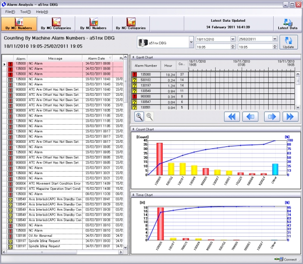

With MPmax, mold manufacturers can confidently transfer work between machines based on conditions of overuse and underuse to even the flow of work throughout the shop floor. Its Pareto chart display of alarms offers manufacturers an opportunity to review a full list of alarm events to adapt machine process for alarm prevention. Recorded electrical energy usage can assist manufacturers in scheduling jobs for various times of day based on fluctuating energy costs for enhanced savings.

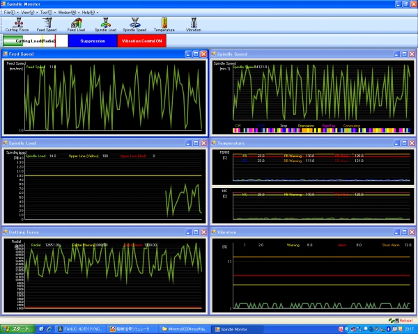

Through spindle and axis movement, probe data analysis and tool management data, MPmax provides the capabilities to measure current machining processes and their impact on critical die and mold features.
Its ability to collect probe data and calculate the Cpk process capability index lets mold manufacturers track accuracy performance in critical features and ensures the highest level of die/mold quality by preventing processes from drifting out of tolerance. The MPmax spindle and axis monitoring technologies record and display axis forces, loads and speeds. Manufacturers can then use this data to fine-tune their processes for faster cutting speeds and greater depths of cut in areas where cutting forces are low.
The MPmax tool data management system enables manufacturers to register, manage and monitor all critical tool data for multiple machines from one centralized location. By making appropriate adjustments based on this data, mold-manufacturers can get the highest level of performance out of each tool while extending tool life.
