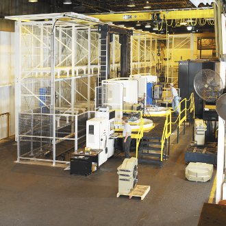

   •  An MMC2 automated material handling system consisting of 22 pallets (11 per machine)
   •  Two A100E horizontal machining centers with a 244-tool magazine
The MMC2 would enable employees to load several parts onto fixtures and then let the machine automation handle the rest of the work.
With this automated machining cell, Twin Disc is experiencing improved cycle times, reliability, added manufacturing flexibility and reduced labor. It is experiencing a 30 to 40 percent decrease in cycle times on the problem transmission housing, most of which came from reduced setups and faster feedrates. On one particular part, the automated machining cell has cut the process time in half—from 14 hours to seven hours. With the Makino machines, Twin Disc is producing perfect parts—something that definitely couldn’t be done on the old machines.
Twin Disc now has the manufacturing flexibility to switch from job to job on demand to help meet requests for just-in-time parts. With the automated machining cell, labor has also been reassigned to other areas. The company used to assign one person per machine, but now one operator can handle two machines. It is also saving costs in areas it didn’t expect, such as in tool life and tool changes.
